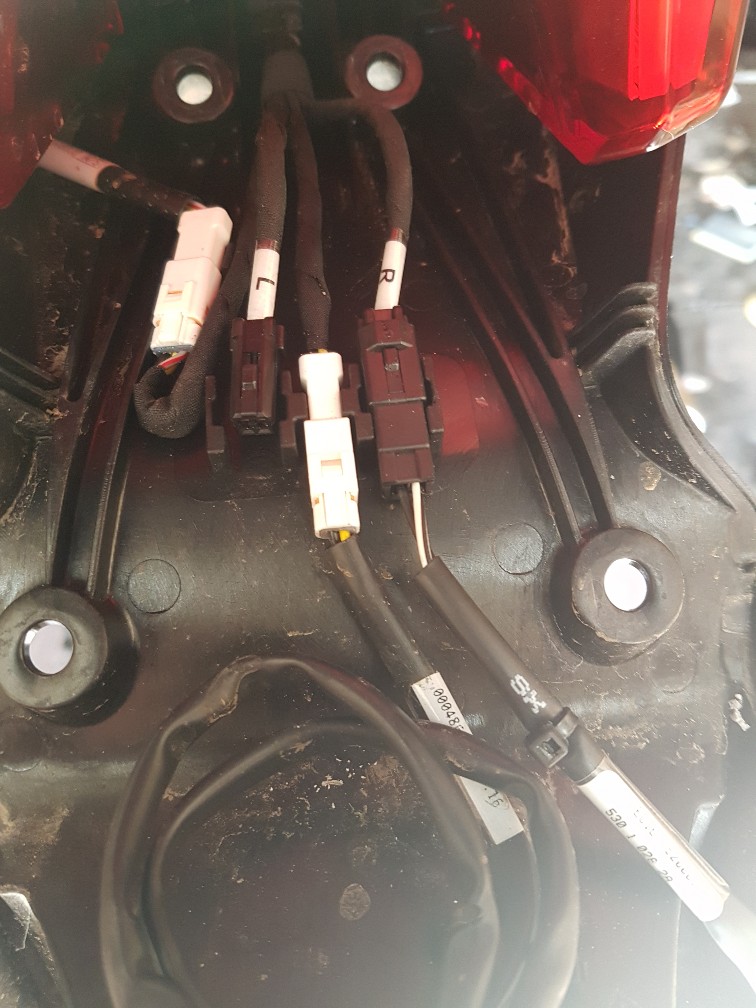

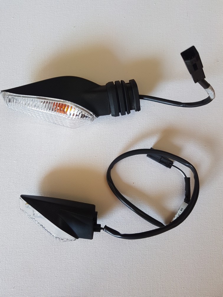

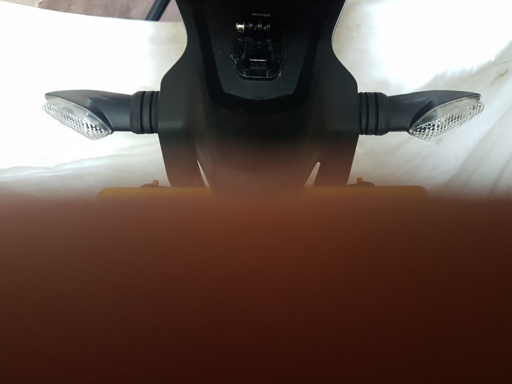

These are ducati original panigale indicators
50.00 ebay or local dealer multistrada one's are over 110.00
Remove number plate then 4 bolts on the underside of rear light
Simply plug and play no alterations to existing wiring
You will need to re use the rubber section from you original indicators simply un screw and fit to new  indicators
Same shape but half the size and brighter

Good find Murf 46 and good pictures and information, you must off had the last pair on ebay as I'm unable to find any at the moment

Got my Leds today, fitted and working and much brighter good find Murf 46

Thanks for the heads up, should of had them fitted as standard. Changed mine at the weekend, look so much better. Cheers.
