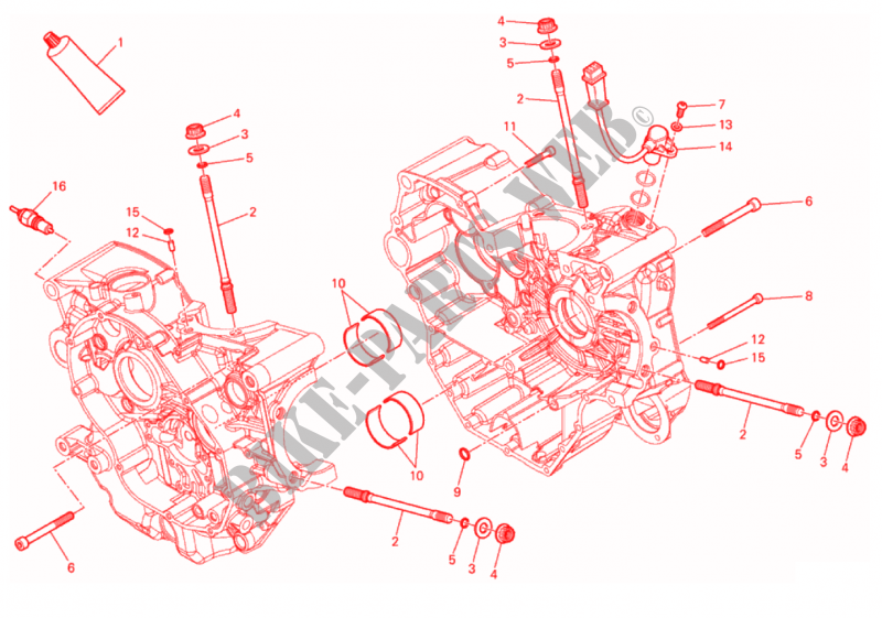

    Looks like an external component, item 16

     Thanks Goldstar - yep I checked on that site as well - so potentially it doesn't look too bad
