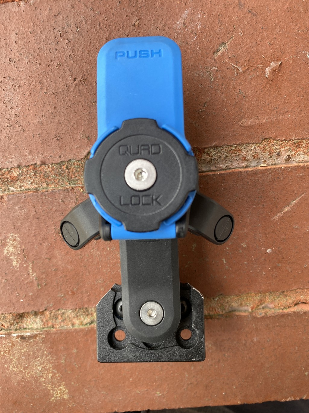

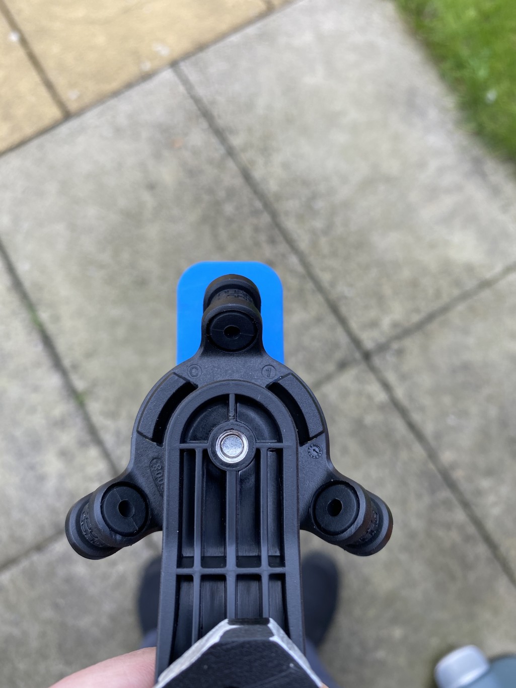

    if any of you use the Evotech Performance Quad lock holder, you will have found out that the new vibration damper does not fit. well....physically it does but you have to force it to sit at an angle which eliminates the "suspension" I tried spacing it away from the holder with washers but to get it far enough away the pressed in screw was not long enough.
    here are the options that I have worked out:
    use the extension bar & all It works as designed
    or cut the 2 bottom corners off the plate to allow the bottom 2 fins to float & I did still put a washer in for good measure.
    and yes I know I need to repaint the holder
