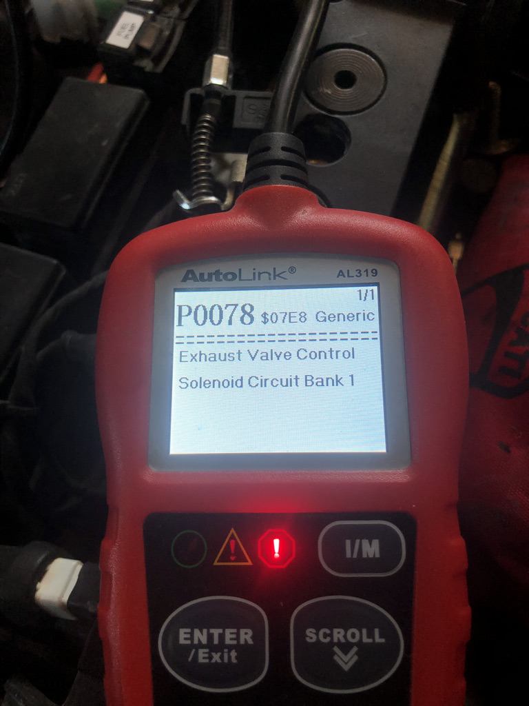

    My light came on when my exhaust flapper valve went kaput. You have to disassemble a bunch of the bike to pull out the motor, so I just installed a servo buddy to get the light to turn off. Planning on getting an aftermarket exhaust at some point which would eliminate the flapper anyway...
    As is my philosophy on any modern vehicle packed full of electronics, you're doing yourself a disservice if you don't have a code scanner. CELs can be triggered by a countless array of issues, some minor some critical. The vehicle is pretty much telling you (this is what I think is wrong) so why not listen.
    You'll need a 4-pin adapter for the Multi which can then be connected to any of the code scanners out there.

    My problem turned out to be a stuck exhaust servo valve as well. My local mechanic was able to clean it up and unstick it and warning light is no longer illuminated. I have a Healtech servo eliminator on order which, for £39 and a ten minute fit time, looks like a good investment and should ensure the problem never recurs

    Mine went under warranty. The cable actuating the flap snapped. Ducati didn't even bother replacing the cable, they just fitted a bypass thing. The actual flap was solid but luckily stuck in the fully open position.
