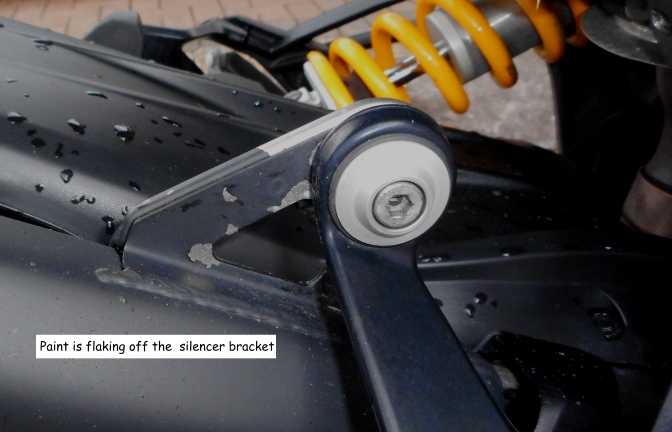

    I have to mention we have been riding through some pretty atrocious winter weather this year, with bucket loads of salt on the road. I also ride past some major construction work all of which coat the bike in crap within minutes and given it a bit of a neglected look at times.
    However even after being side swiped by some clown in an Audi, with a quick hose down on the whole the bike is still looking pretty fresh, although on closer inspection some exposed metal is looking a bit tarnished.

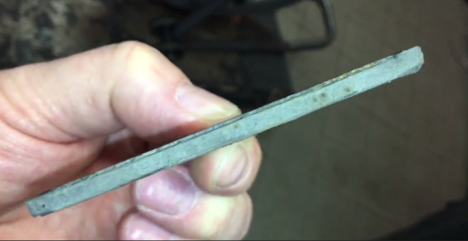

    A couple of hours later I was contacted by Mark, the service centre manager. “We’re going to have to change your brake pads, they’re all worn out. All of them. You’ll get away with the disks we think but the rear one has a lot of scoring. We’ve emailed a video”. Bit of a shock! I didn’t fancy paying Ducati prices for the pads and I can fit them myself and save £100, so I asked them to finish the service and when I get home I’ll sort it. After all with only 9000 on a set they can’t be that worn even if they’re close to the limit.
    A bit later, after they’d had a closer look Mark ‘phoned me back. “We just can’t let you ride out on them, there’s nothing left on one pad and three of the others are on the wear limit! I’ve sent another video” Sure enough they were shot.
    So we did a deal to tag the replacements on to the service and I ended up with new pads all round. I’ve measured the disks with a Vernier calliper and they’re half way to the limit. So next time it’ll be them as well, going on for £500 for the whole lot – gulp! Let’s hope the aftermarket guys have got their act together by then.
    But that wasn’t the end of it. The head bearings are notched and the cush drive and drive sprockets are also worn. I can’t see the sprocket wear so I think it’s just normal wear for the mileage, the cush drive is not excessive either apparently. However the head bearings are not good which is unreasonable at that mileage and age so a claim has gone in for a warranty replacement. I’ve yet to hear back from Ducati but they sometimes see them as consumable parts and I may be unlucky.
    A final cost of over £420 for everything is a real shock for what started as a basic service and that’s after Ducati Manchester did their best to soften the blow! We don’t know why the pads are so worn, favourite theory is the grit on the roads has ground them down. They were also not moving very freely in the calliper with all the accumulated crud. I’m not so sure, I’ve had seized pads before and I could tell while riding. I’ve also seen riders quoting 6000 to 9000 miles from pads on an MTS1200. Maybe it’s what they do, we shall see.
