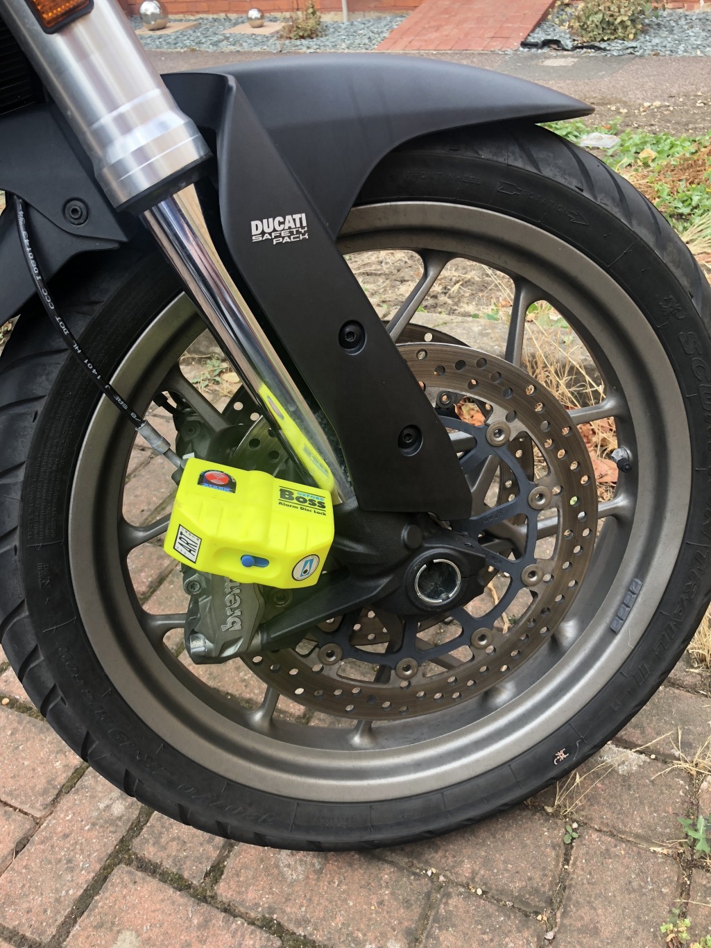

    Hi all,
    Whilst washing my bike after a long trip to Europe, I noticed the deformation of the front wheel as shown below.  :230:
    There was no sign of damage to the paint or tyre, so I'm not really sure how it happened. I don't remember hitting any particularly huge bumps an couldn't notice any unusual handling.
    Anyway. after a little bit of umming and aahhing and indecision (ignore it, repair it or replace it), I acted on some advice I got from another forum and gave http://www.motoliner.com/ a go. It meant a 90 mile trip down to Maidstone but there are precious few places I could find who repair motorcycle wheels and given the price of a new one, I thought I'd give it a go.
    Well, I just arrived back home and can confirm they are excellent. I rode in at 8am, they removed the wheel, tyre and brake disc, removed the paint from the damaged area, repaired it, repainted it, rebalanced it and refitted it. I was on my way home by 11.30. Looking at my wheel now I literally can't even tell where the damage was. Well worth the £160.
    Just in case anybody finds themselves in a similar position one day. They appear to make a living straightening wheels and frames of road and race bikes.

    I hit a pot hole & my wheel has similar damage & I’ve had it inspected by 2 wheel repair/refurbishers & both have told me it’s not safe to repair so its £1044 for a new wheel
    Motorliner is one of the companies that told me my wheel was unsafe to repair
    Last Edit: August 11, 2018, 03:54:21 pm by BabyD

    Wow looks like I got very lucky as damage is quite similar!
    They did mention they had seen another MTS wheel just yesterday which was cracked (they were worried mine would be the same) I suppose that could have been you!?

    Yes it was me, the first 950 wheel they had seen
    Mine was bent on both sides

    Yours looks slightly worse .. . Mine was still holding air so I could ride on it... Is yours?
    £1,000 is no joke. I was also worried it would take 6 months for Ducati to actually get one here given the state of accessory availability and supply.
    Sorry to hear about your misfortune (and for accidentally rubbing it in!)
    Yes it hold air, I must of done 150 miles before I noticed it
