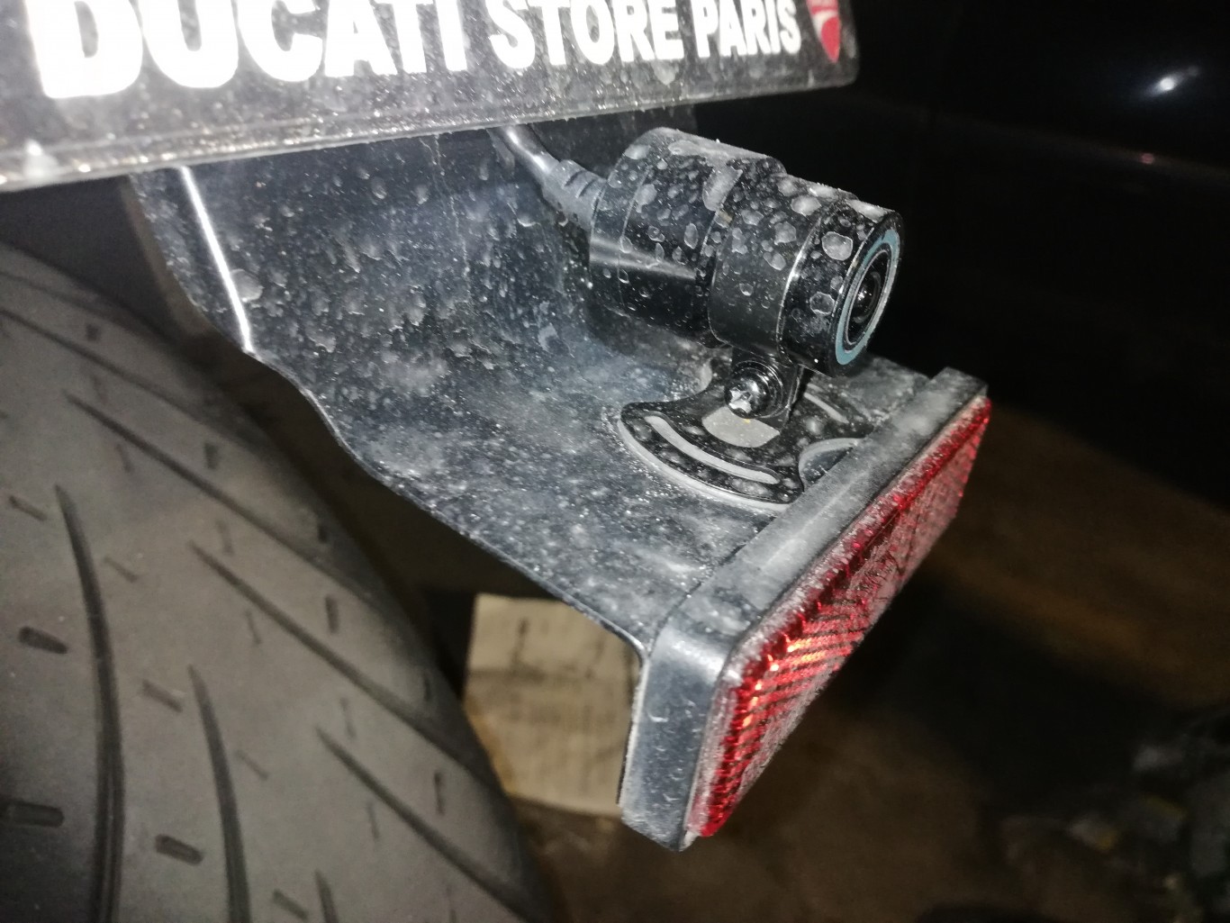

    I chose it because of the wide angle lenses and the wifi connection to see the video on my phone. It records front and back in loop automatically when turned on, and deletes the older videos when the card is full. I plugged it on the din docket under the seat which is powered with ignition, contrary to what the manual say (the USB socket seems limited to 1 amp which is not enough).  So I just forget about it now.

    It's true that sometimes the plates are not clearly readable, but sometimes they are, and also I think the video would useful if the driver stops but contests what happened. You can just show them the video on the spot before  filing the papers.
    Here's a few photo of the setup, I ran the cables under the right side panels, you can't really see more than the  cameras.
